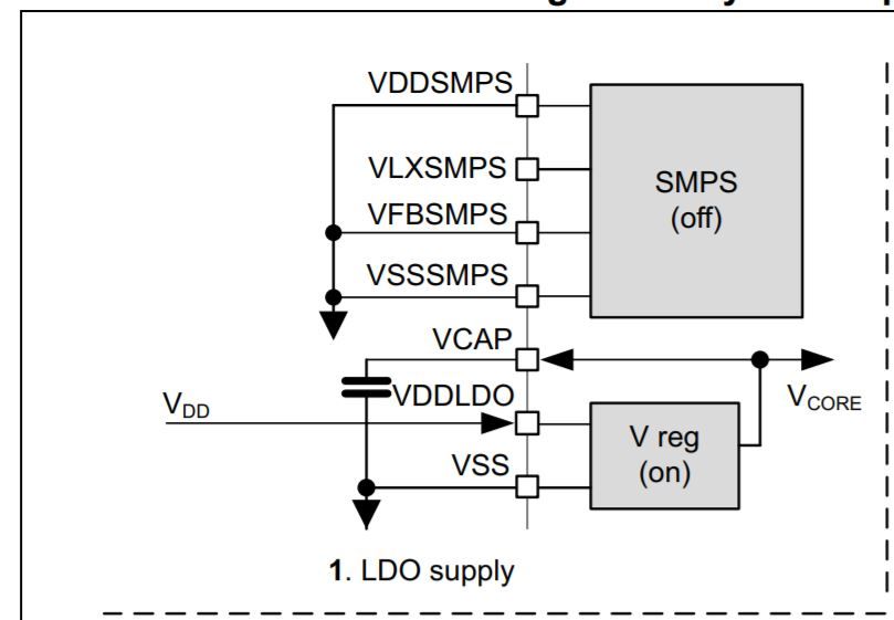

My board implements this LDO use case from the user manual, no SMPS components and no SMPS circuit:

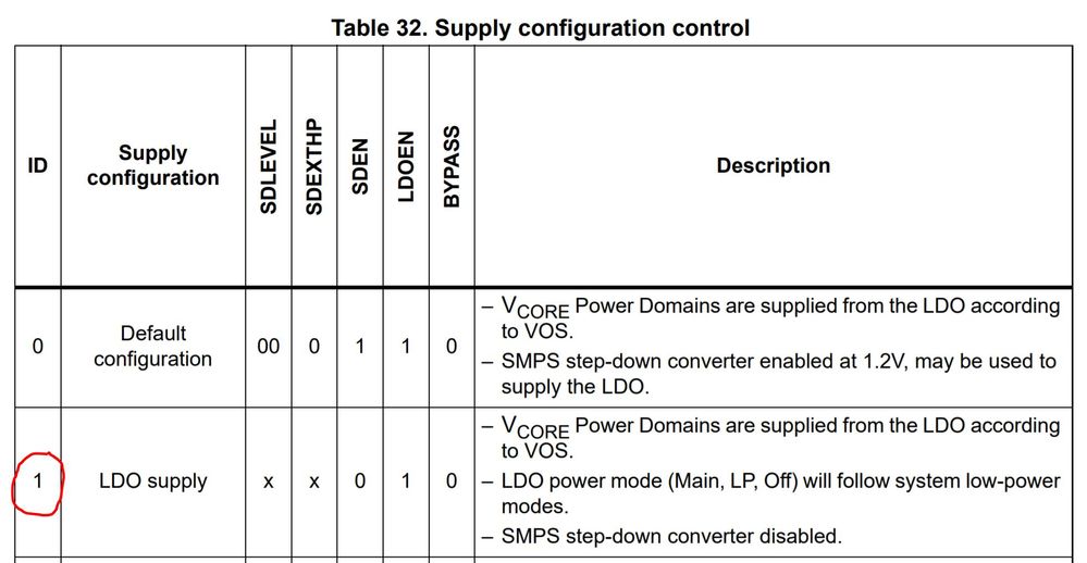

I need to enable this configuration:
However the device rejects ALL changes to these bits so the default configuration will not change to the LDO supply (or any other supply use case).

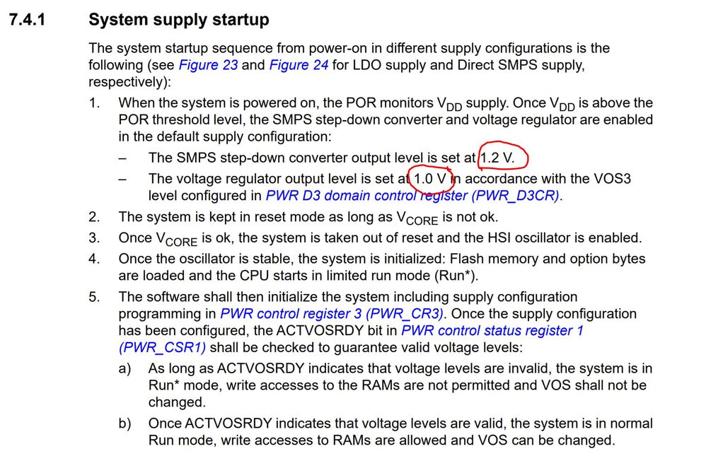

Service manual startup sequence has some clues:
Using my multimeter to probe the LDO output, I see 1.0 V but I cannot see 1.2V on the SMPS, because I don't have SMPS components installed on the board as per LDO use case above.
Is the PWR unit waiting for the SMPS 1.2V before permitting changes to the registers?

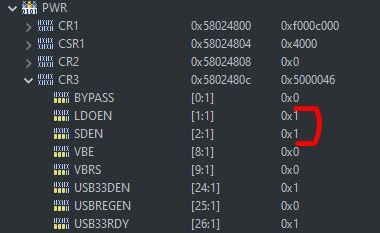

This was the status of the registers when I first powered on the device with the boot0 pin shorted out. You can see that LDOEN and SDEN pins are enabled in CR3. This should not be the case it should only have LDOEN set. Also notice that the ACTVOSRDY pin is at 0 inside CSR1 register
After fixing the boot0 button this issue was resolved and the CR3 register read the correct configuration and the ACTVOSRDY pin was set high meaning valid
