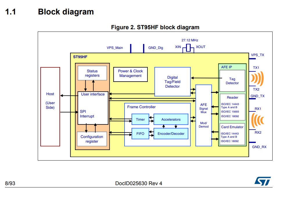

In datasheet, ARC_B and ACC_A register are configurable for Reader Mode and Card Emulation Mode. According to ST95HF block diagram, Tag Detector is a seperate part beside Reader and Card Emulator. Is there any guideline to set ARC_B and ACC_A register for Tag Detector?

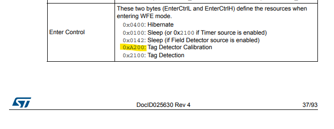

Ps. As in datasheet page 37, the Enter Control for tag detector calibration is 0xA200. Anyway, I also tried 0xA100 and both seems work correctly.
2020-07-16 1:25 AM
there is a typo in the Datasheet, the correct value is 0xA100. The description of the various bits is available in the ST25R95 datasheet (table 27), bit 1 of CtrlH is RFU and therefore 0xA2 does not make sense. The typo is also in the CR95HF datasheet and in the ST25R95 datasheet.

TagDetector does not use any modulation, therefore there is not need to send a protocol select command before entering the IDLE mode. Same for ARC_B and ACC_A: not needed for tag detector.
