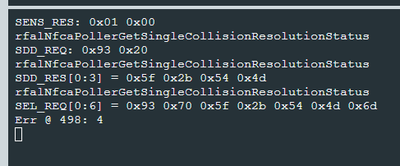

As I've continued debugging today, I found that the NFCID is being transmitted properly, but RFAL is returning a timeout error (see pic 1 below).
I switched from the values directly in the RFAL when it's in Listen Mode, and these SENS RES values: {0x01, 0x00}, {0x10, 0x00}, (0x08, 0x00}, {0x04, 0x00}, {0x02, 0x00}, {0x01, 0x00}.
So far as I can tell, there's some problem with the ST25R3916 causing it to successfully send a SENS_RES and SDD_RES, but not the SEL_RES. My next step will be to comb through RFAL configurations and registers again before I just go and implement anti-collision manually.
