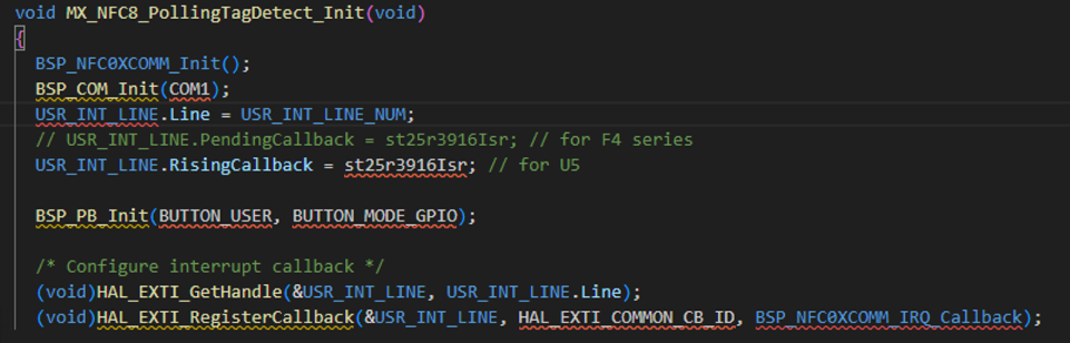

After tracing, I found that execution stops at the following segment:
Additionally, "BSP_NFC0XCOMM_IRQ_Callback()" is not triggered as expected.
I am aware that EXTI configurations differ between STM32U5 and STM32F4, so I modified the settings as follows:
The SPI initialization appears to be correct, but the issue persists. Could you help check if there are any potential issues? Thank you.

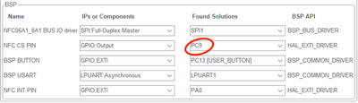

Thank you all for your replies.
I have confirmed that the issue was due to an incorrect CS pin configuration. The NUCLEO-L476 and NUCLEO-U545 actually have differences in their pin assignments.
Below is the correct configuration, which can be used for NUCLEO-U545 + ST25R3916B (X-NUCLEO-NFC08A1).

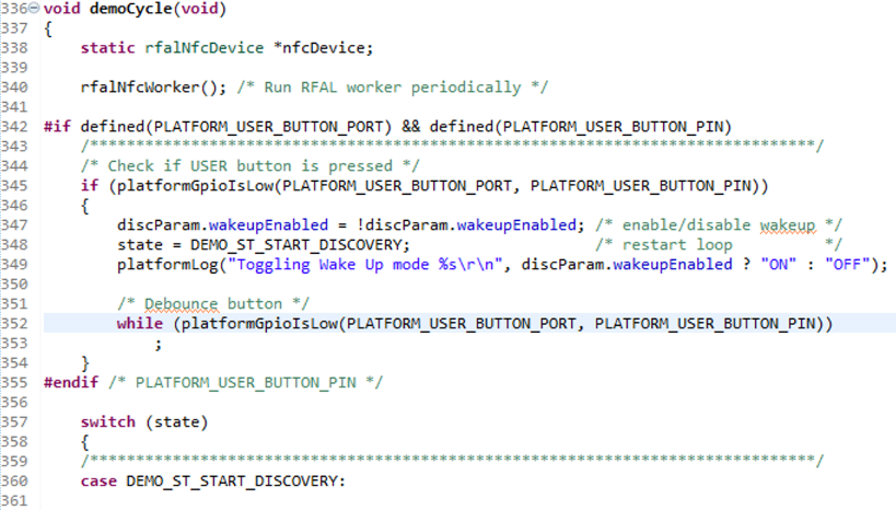

@biopunk101 wrote:After tracing, I found that execution stops at the following segment:
Where, exactly, in that segment?
This line:
That's waiting for the pin to go high - so have you checked (eg, with a voltmeter) if the pin ever does go high?

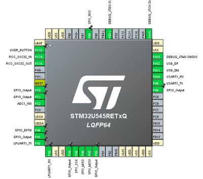

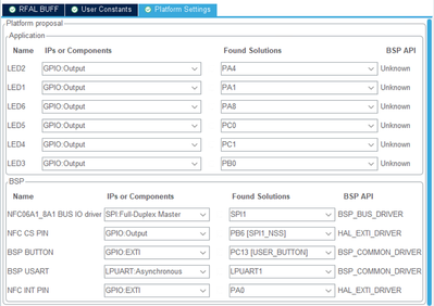

2025-03-11 10:16 PM - edited 2025-03-12 12:28 AM
Thanks for your reply and reminder.
Now, I understand that the button configuration on STM32U5 and F4 is different. I am using the NUCLEO-U545 to test.
I also referred to the NUCLEO-L476RG, where the interrupt (INT) is connected to PA0, and I believe it should be the same for NUCLEO-U545.
However, the ISR is still not working. My current settings are as follows:
Is there anything else I need to check or modify? Any suggestions would be greatly appreciated.
2025-03-12 8:09 PM
