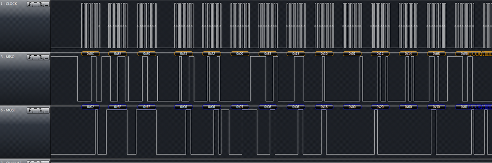

After we send the 00 02 02 00 00,the ST95HF replys a lot of code back,which more than 50 byte.

________________ Attachments : The error codes.logicdata.zip : https://st--c.eu10.content.force.com/sfc/dist/version/download/?oid=00Db0000000YtG6&ids=0680X000006HyKR&d=%2Fa%2F0X0000000b8R%2FH6VWbLfSLP49ZuOKU.FhfkAwpr_PUD6XZj5cnvo3Jvw&asPdf=false2017-08-24 1:20 AM

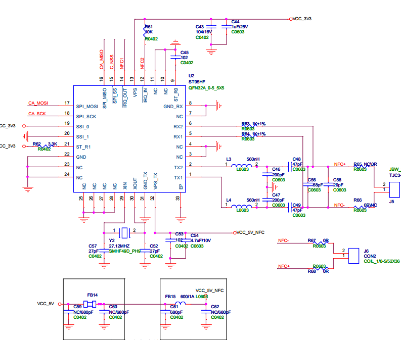

We do want to select 15693 protocol to read 15693 tag.At our design,the VPS is used 3.3V for supply voltage,and the VPS_TX is used 5V for supply voltage.But i do not see any suggestions about the VPS ?VPS_TX have to be designed with the same voltage in the ST95HF DataSheet. There is my design schematic diagram below.Looking forward to your more suggestion.
2017-08-28 2:03 AM
Posted on August 28, 2017 at 11:03
1) If you want to read/write ISO15693 Tags, you first need to select ISO15693 protocol by sending the following command to the ST95HF:
-> 00 02 02 01 1D
2) What I intended to say by '
You cannot change
VPS_TX voltage only', is not that you must have VPS_TX = VPS_Main. But if you design your board with VPS_Main = X.X Volts and VPS_TX = Y.Y Volts, you cannot change those values without adapting the board (antenna tuning, capacitors, ...).
You can refer to the
<LINK NO LONGER ACTIVE>
to help you and there is a
too for the antenna (These documents are wrote for the CR95HF but are also applicable to the ST95HF).

I had follow the antenna design guide and used the calculation tool to design the antenna. Is there any problem
with VPS_Main = 3.3Volts and VPS_TX = 5 Volts,would it do harm to the ST95HF.

There is no problem to use ST95HF
with VPS_Main = 3.3Volts and VPS_TX = 5 Volts. O
ne thing to be aware is that the signal on RX1 and RX2 (between RX1-GND and RX2-GND) does not exceed 8 Volts. With your 1Kohm resistor, this is very sufficient to attenuate the signal.Your command to select ISO15693 protocol is OK and the ST95HF should answer:
