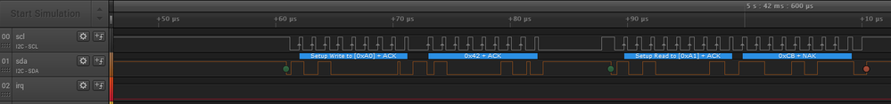

register access to the ST25R3917 is possible without (running) oscillator/external crystal.
When software enables the oscillator (en bit) and the I_osc interrupt is not masked the IRQ line will be driven high once the oscillator is deemed stable. Such does not happen automatically.
The 32kHz on MCU_CLK indicates that the internal low power oscillator got enabled.
I would start looking at the I2C protocol - most common is a shift of the address - whether direction bit is included or not.
As reference you will find here a read from ST25R3916 (with address 50h, shown here as 0xA0) from register 02h. I recommend starting with read from register 3Fh (IC identity), where you will need to send 7Fh instead of the shown 42h.
0693W00000LxK32QAF.pngBR, Ulysses
