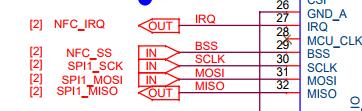

2022-01-20 1:23 AM
Sorry for not speaking English.
It is a schematic and It's directly connected to the GPIO of the chip.

2022-01-20 2:56 AM
NFC_SS is denoted as an input from MCU side in the schematic, it should be an output.
BR, Ulysses
