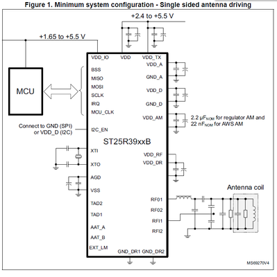

2024-07-31 3:33 AM
Hi Peter,
The above design uses the device two channels (RFO1/2 and RFI 1/2), I thought there is an implementation with one channel as in the DS (see below).
Is it better to use the two channels with one antenna?
Thanks
Shay
2024-07-31 5:16 AM
You can drive the antenna either differential or single. As you mentioned, the X-NUCLEO-NFC08A1 works differentially, which is why RFO1/2 and RFI1/2 are used. If you want to use single driving, you only use either RFO1/RFI1 or RFO2/RFI2 and set the corresponding bits (IO configuration register 1, bits 7 and 6).
