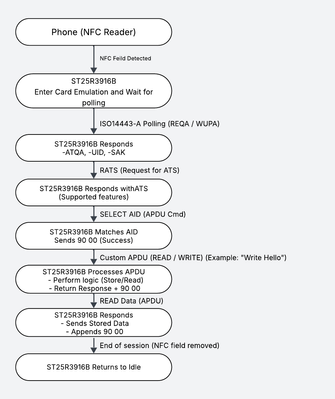

Actually we are already sticked into ST25R3916B this IC so we cant go to some other and we have planned for polling and FW update to microcontoller using NFC . I have attaced my flow diagram below for polling and FW update please analyse it and tell me whether it will work or not. If not please explain me why and If yes tell me what are all the difficulties I will face during this process

if both the ST25R3916B and the phone can act as a reader and a Card Emulation, you may face some issue. You may need to move the ST25R3916B into Card Emulation only through a user action and otherwise run the ST253916B in reader mode only. Can you elaborate on your ST25R3916B reader mode use cases ?
The ST25 Embedded NFC library provides different demos for the ST25R3916B:
I would suggest to have a look to those demos. The Card Emulation is based on the NFC NDEF; if you plan to have your own private AID, some modification in the handling of the APDU will ne needed.
