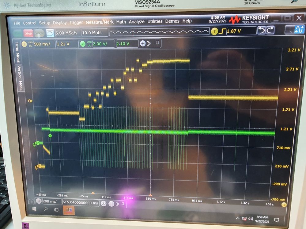

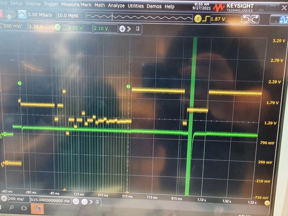

Below some scope images of the AAT_B output (Yellow, green is data transfer).
AAT with an antenna with capacitance and the first card read.
AAT of antenna with high capacitance

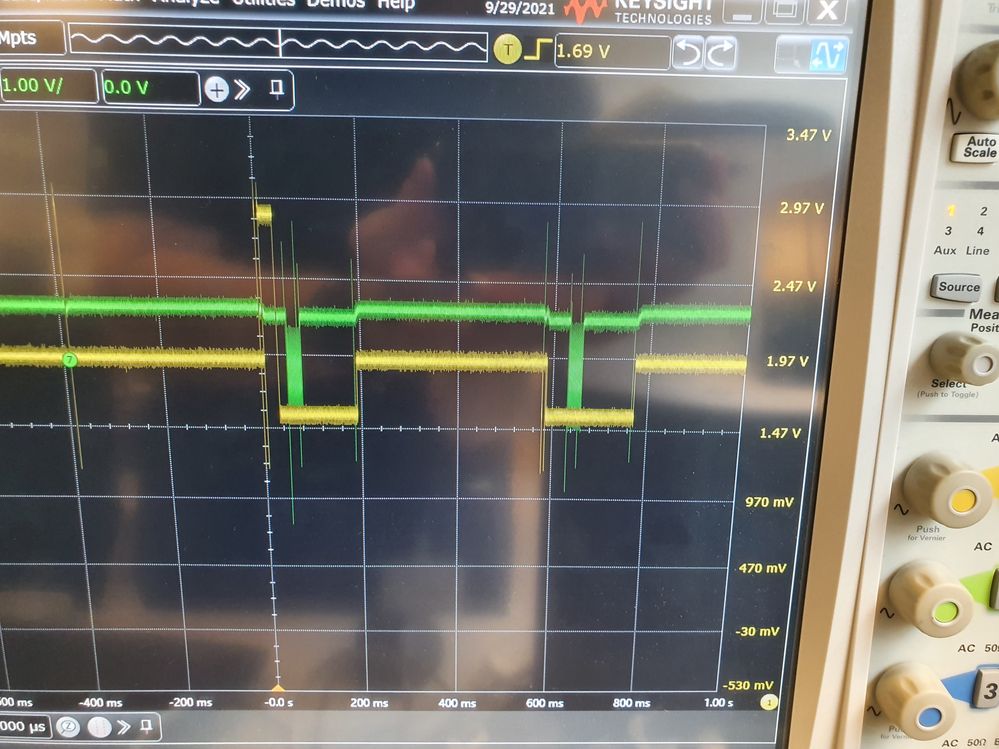

First and second card read of antenna with high capacitance.
Also if any have a quick explanation/link to an note of why the voltage always is at 1.5V every time there is data transfer (Green line). I will appreciate that as well.

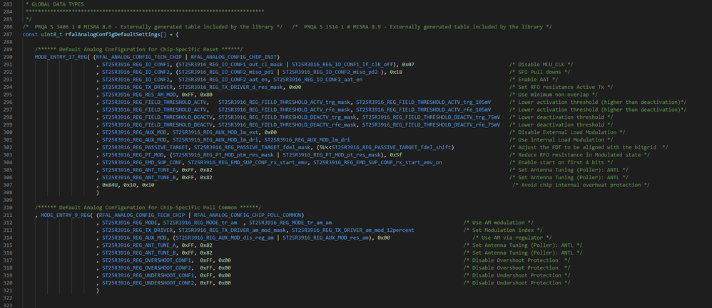

DAC/AAT values are by default defined inside the Analog config. Even if you run the algorithm as soon as you communicate the values inside Analog Config are prevailing. Please refer to AN5322 chapter 8(.2) for some details and how to avoid these effects.

I am not completely grasping your scope shots: What is the green line (you said data transfer.. Is this reader modulation or tag load modulation? And where did you connect it?)

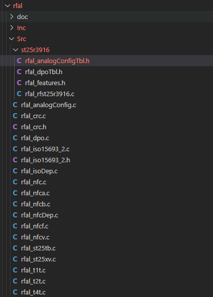

In the RFID we have these included files where I can see predefined values in the file: rfal_analogConfig.h.
in this const array with default values, i tried to remove the parameters for the ...ANT_TUN_A/B but it didn't work.
The green is the reader modulation, it was connected to one of the wires to the antenna print. the images was just for visualization of the aat_b output.

the MB1414…_for_aat.xml is part of stsw-st25r010 - the PC GUI. I can attach the xml files - they are more or less directly translatable into rfal_analogConfigTable.h. In that file you will need to remove all the occurrences of ST25R3916_REG_ANT_TUNE* (4 occurrences, 8 regs overall).
