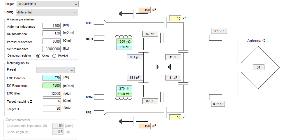

Hi Travis, I keep working on my RFID project and I manage to increase my reading time to approximately 20ms. I don't know yet if I’ll use a dynamic tag such as ST25DV04 or design a custom tag in order to customize the protocol and increase the time needed to send data (probably only 32 bits, something like that)
I have 2 more questions regarding this :
but the results are not really good. Is there a problem somewhere? I use a 2 turn 20x30cm antenna, is my inductor value too high?
Tank you
Vincent
2022-09-06 4:35 AM
Hello Vincent,
I assume you are using the inventory command to collect all UIIDs in the field. The disco GUI is driving the ST25R3911B. So there is the USB interface in between. this is causing additional delays. It might be possible to further optimize if the code is directly running on the MCU. If you could share a bit more details about the used commands we could do further proposals.
The inductance value should be still in a good range. Can you maybe share the smith chart coming from the VNA?
Thanks, BR Travis
