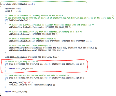

2025-07-11 12:10 AM
the first step of the RFAL library is that in rfalInitialize() and st25r200Initialize() which is inside rfalNfcInitialize(), osc_ok is not set in st25r200OscOn() function and it throws an error. What can I do?
