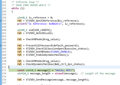

I have found that the function doesn't get caught if I do not call my enable Dynamic Mailbox function.
If this function is called the following occurs.

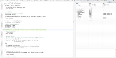

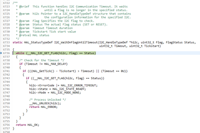

In I2C Mem Read it goes to an error handler at the highlighted line:
This is the error handler that it gets stuck in:

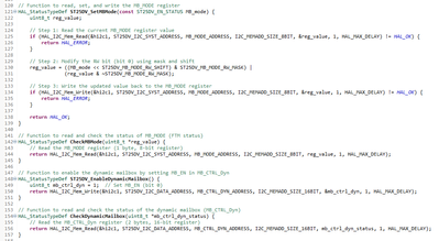

My set MB_MODE function does not seem to be working as the check function is not returning 0x01.
Thanks again.
Changing the I2C_MEMADD_SIZE_8BIT to 16BIT seemed to fix the error.
Both MB_MODE and Dynamic Ctrl are being set and read correctly now.
