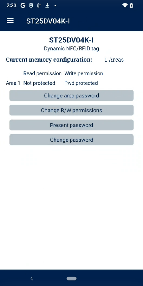

Can you please check that you are in the following state according to Area Security Status feature:

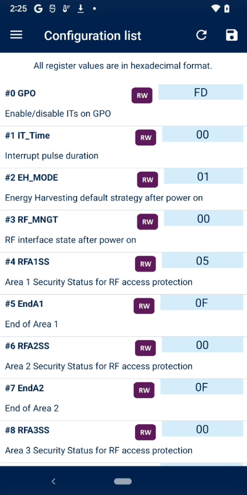

and check also the registers and RFA1SS value:
With following configuration i was able to update NDEF presenting password1 during Write process, can you please check theses points and be sure your password is correct...
You can also go to register value and reset the RFA1SS to 00 to reset any security status on Area1 and try again ...

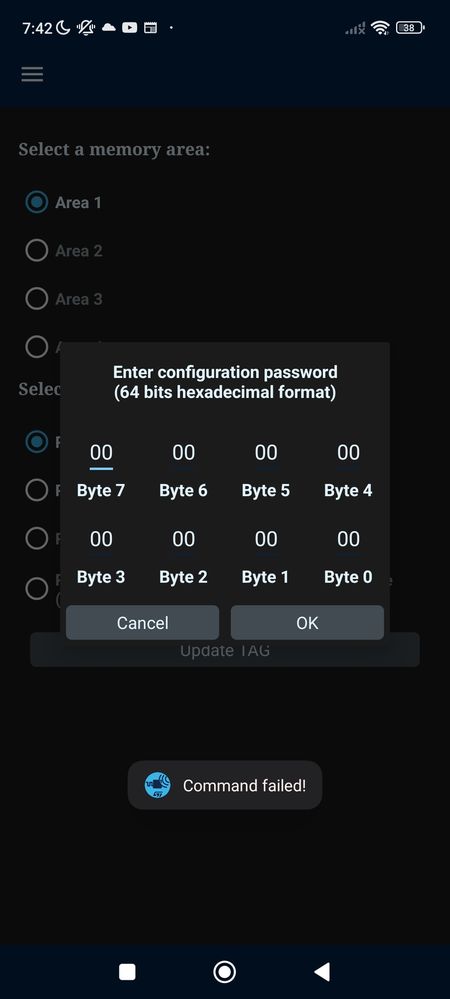

Hi! I checked the configuration and I the registers related with Security Status are the same. Then I tried to configure a new and empty memory but when I try to present the configuration memory I have this Toast, but I cannot read why it fails.

Your area seems to be not protected.
In the video you do a present pwd and you change "default one". I suppose you have updated the pwd before and your change is effective.

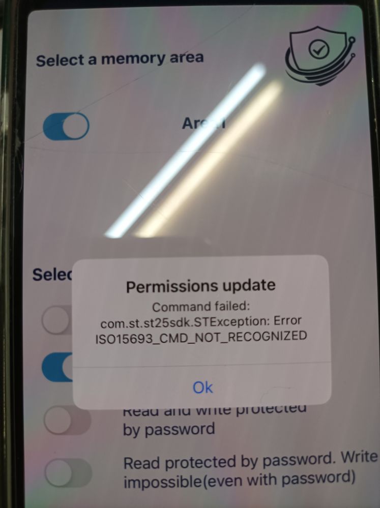

I got this error in iOS related to ISO15693_CMD_NOT_RECOGNIZED.
In addition, I have tested in multiple phones and some of them don't work, but others they do. I have checked permissions for the app and everything is ok
For example, I can write without password and everything works good.
