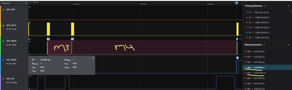

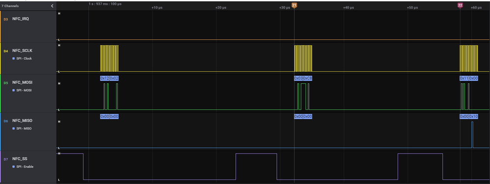

}Addresses aren't incremented: I'm not exactly sure what was meant by this, but maybe the following pics will help. The first two show how a short/long timing interval swapped between gcc7.5 and gcc9.4.

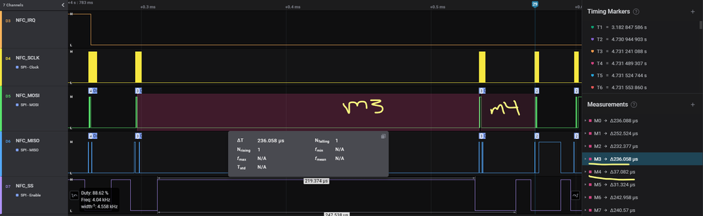

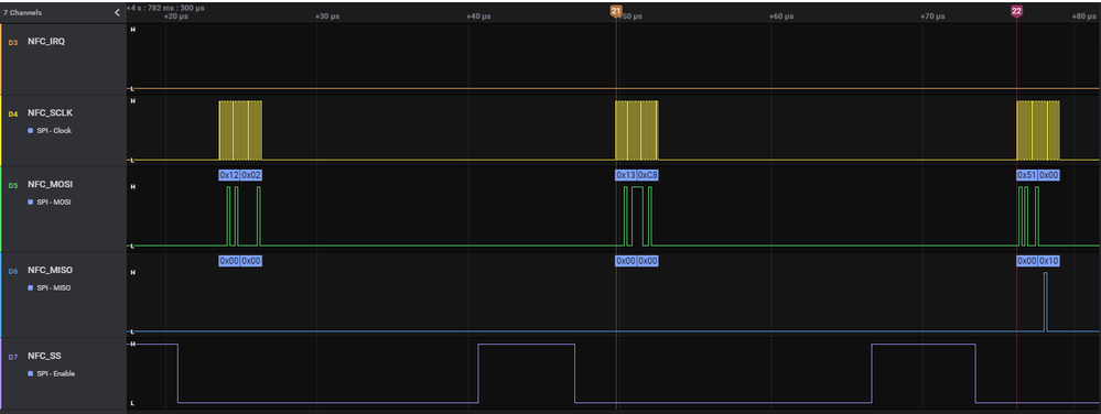

The next two show a change in increments:
