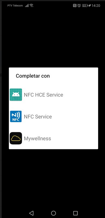

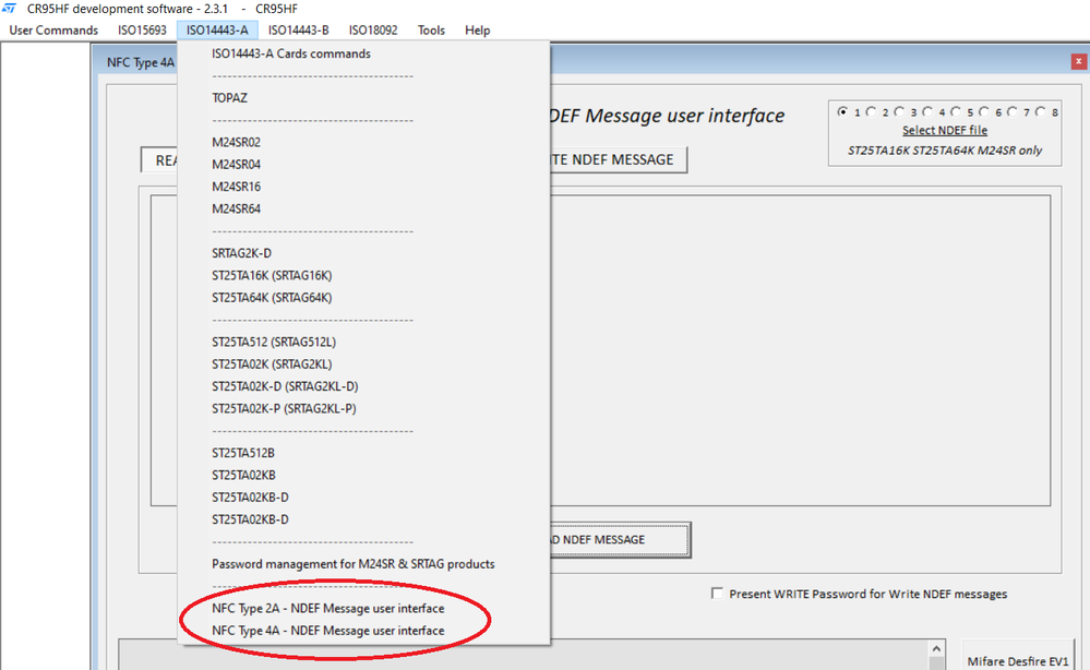

I am using NDEF tag emulator in my Andriod phone. But I Can not read a simple NDEF message with my evaluation kit (NDEF type 4A).
When clicking "READ NDEF MESSAGE" a list of service pops up on the phone, I select the one for the emulator and nothing more happens.

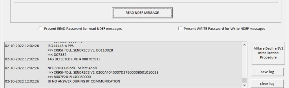

Full log:
02-10-2022 12:07:18 RESET SPI
>>> CR95HFDll_RESETSPI
<<< 8000
02-10-2022 12:07:18 ECHO
>>> CR95HFDll_ECHO
<<< 5500
02-10-2022 12:07:18 RF OFF
02-10-2022 12:07:18 CR95HF CONFIGURATION : ISO14443-A protocol
>>> CR95HFDLL_SELECT, 02000280
<<< 0000
02-10-2022 12:07:18 ISO14443-A : CONFIG
>>> CR95HFDLL_STCMD, 0109043A005804
<<< 0000
02-10-2022 12:07:18 ISO14443-A : INCREASE DEMOD GAIN
>>> CR95HFDLL_STCMD, 010904680101D3
<<< 0000
02-10-2022 12:07:18 RF ON
02-10-2022 12:07:18 ISO14443A REQ-A
>>> CR95HFDLL_SENDRECEIVE, 2607
<<< 0400
02-10-2022 12:07:18 ISO14443A ANTICOL 1
>>> CR95HFDLL_SENDRECEIVE, 932008
<<< 08869A7C68
02-10-2022 12:07:18 ISO14443A SELECT 1
>>> CR95HFDLL_SENDRECEIVE, 937008869A7C6828
<<< 20FC70
02-10-2022 12:07:18 ISO14443-A RATS
>>> CR95HFDLL_SENDRECEIVE, E04028
<<< 05788071006F7C
02-10-2022 12:07:18 ISO14443-A PPS
>>> CR95HFDLL_SENDRECEIVE, D0110028
<<< D07387
02-10-2022 12:07:18 TAG DETECTED (UID = 08869A7C)
02-10-2022 12:07:18 NFC SEND I-Block - Select Appli
>>> CR95HFDLL_SENDRECEIVE, 0200A4040007D27600008501010028
<<< 8007F2019140080000
02-10-2022 12:07:18 !!! NO ANSWER DURING RF COMMUNICATIONAny guess about what is happening?

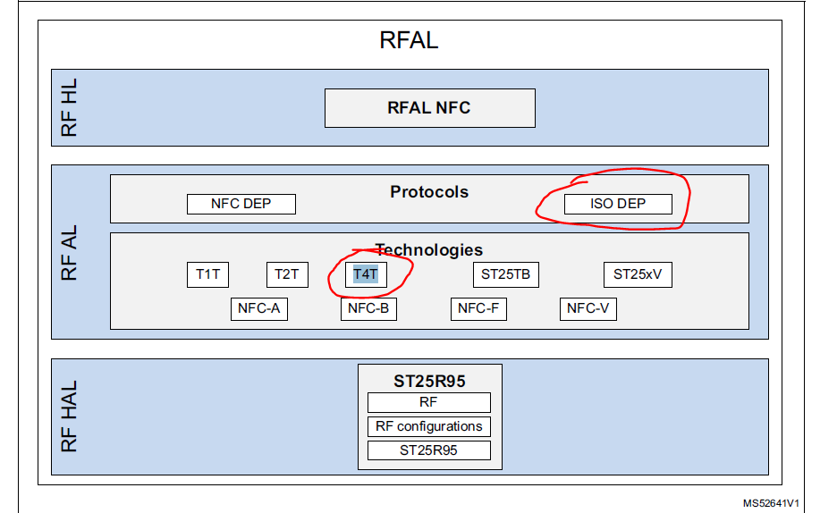

One more thing. In terms of RFAL, which would be the stack to use:
T4T and ISODEP?
Regards, Ramon.
2022-02-10 4:22 AM
Hi Ramon,
an NDEF stack is provided on top of the RFAL. An NDEF read/write demo application is available in the ST25 Embedded NFC library for X-NUCLEO-NFC03A1 (ST25R95 expansion board). I would recommend to use this demo for your application as this provides all you need for NDEF read/write with the proper RFAL configuration.
Regarding your Android App, I see in the trace that the answer to NDEF Application select is incorrect (<<< 8007F2019140080000). Can you make sure the NDEF Android App is currently running in foreground? There should be no popup on the phone when it receives the NDEF Application Select APDU. Which phone (brand/model) do you use? Which NDEF App do you use?

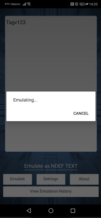

App: "NDEF Tag emulator"
Phone: Huawei P20 Lite
Android: 9.1.0
Yes, app is running foreground and saying "Emulating...."
PopUp arises as there are several compatible services (My guess)
NFC Service is the logo of the App NFC Tag emulator
2022-02-10 6:20 AM
I used to have the same popup on my personal Android phone:
go to the parameters/settings menu in Android, then NFC payement & contactless then contactless payement then Others and deselect all except NdefTagEmulator.
The popup should not appears any longer and the NDEF can be read
