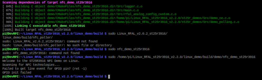

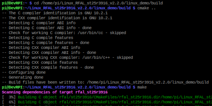

I've been using the software(STSW-ST25R013) and guide(https://www.st.com/resource/en/user_manual/um2548-linux-driver-for-the-st25r3916-stmicroelectronics.pdf) listed on that page. I made a fresh build in hopes there's a step I missed, but encountered the same error. I've included screenshots of the whole process below.
Extraction:0693W00000NsOnbQAF.pngBuilding:
0693W00000NsOngQAF.pngTesting Program:
Ulysses HERNIOSUS
it seems GPIO7 cannot be allocated by our nfc application. Likely someone else is using it. You could investigate (/sys, gpio tools) who is using the device and likely it will give you hints how to disable the blocking function. However I don't have all the tools currently at hand to guide you in detail through the process.

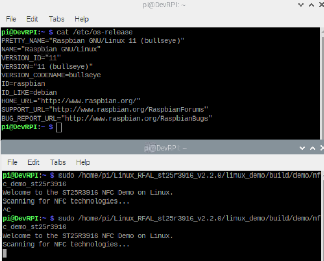

We're using a raspberry pi 4 with Raspbian 11, as the version used in the documentation isn't supported by our pi. After following the updated readme(thank you) and a few restarts we no longer get the GPIO error. The program runs and the led's(F, B, A, and TX) on the nucleo board begin flashing.
  However, it doesn't seem to be picking up any of the nfc tags(known good ST25's and mifare fobs) placed on the antenna pcb. This doesn't return any sort of error to diagnose, it just continues scanning.
I'm currently rechecking the jumper settings and trying a fresh version of raspbian, 0693W00000Nsq9ZQAR.pngincluded is a snip showing the pi's version info and the program's current output.

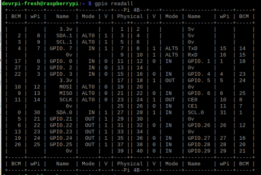

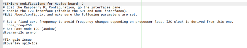

I'm using the ARPI600 configured per this document here- https://www.st.com/resource/en/user_manual/um2548-linux-driver-for-the-st25r3916-stmicroelectronics.pdf - P25...CE1 are connected to A5...A0, and I've double checked all the hardware to the above guide.
I ran GPIO readall to get an overview and I've included it here. Pin 7 seems to be on as an input.
0693W00000Nsz6jQAB.pngHere's the relevant changes I've made to config.txt as well, from updated readme
0693W00000NszBZQAZ.pngIt may be useful(?) that reassigning the interrupt pin to another one(say GPIO 6) doesn't work as a fix in this instance, throwing a similar GPIO init error- which I think supports your analysis.

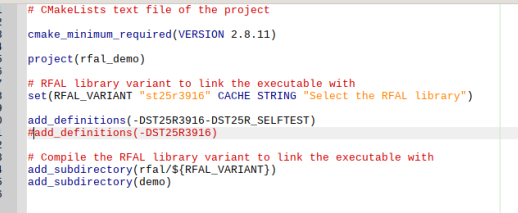

in Linux_RFAL_st25r3916_v2.2.0\linux_demo\CmakeLists.txt, just change
add_definitions(-DST25R3916)
by
add_definitions(-DST25R3916 -DST25R_SELFTEST) then relaunch cmake and then make.

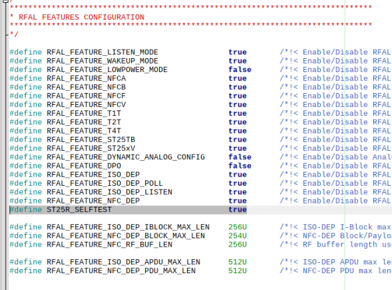

You can also modify the platform.h file to add #define ST25R_SELFTEST and then make.

JMilk.1
Associate III
Okay, thank you!

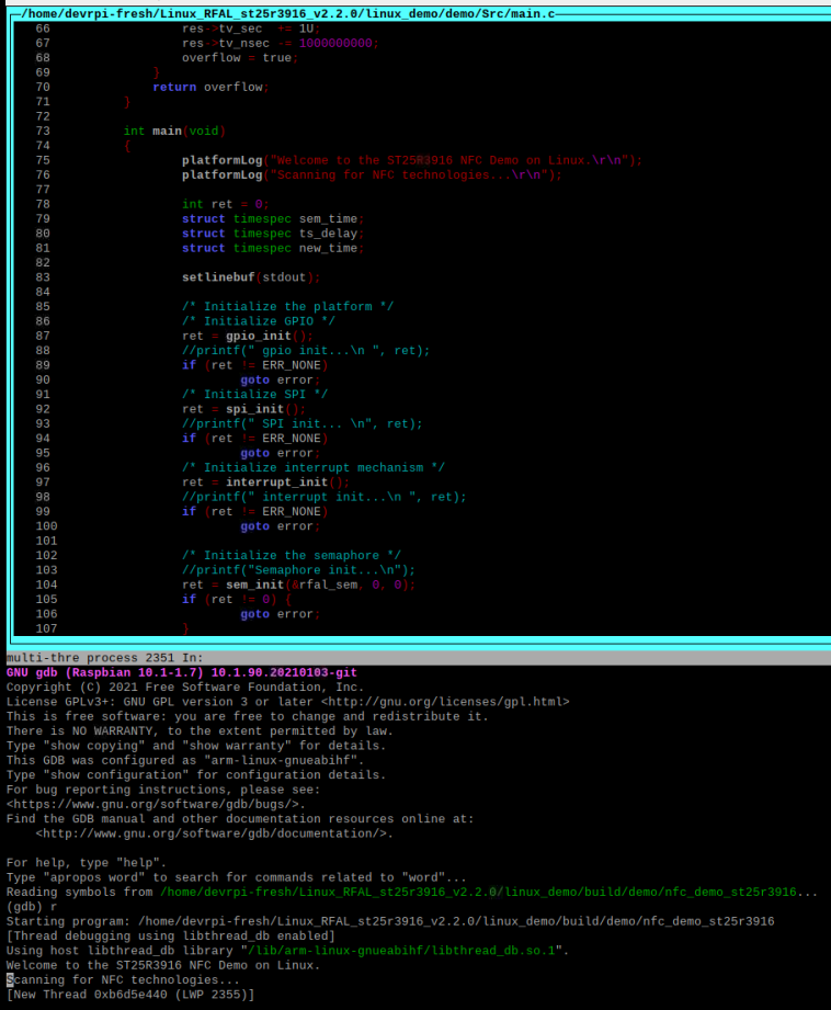

I've tried both of these approaches, editing cmake, then platform.h- shown below:0693W00000Nt4JJQAZ.png0693W00000Nt4JiQAJ.pngNeither produces any visible change, but I may be doing it wrong. I made a build with "cmake -DCMAKE_BUILD_TYPE=Debug .." per the readme file, here's what I see in the GDB text ui
0693W00000Nt4OYQAZ.pngWhere should I be looking for st25r3916Initialize? Is it a function somewhere or it's own program within the package?

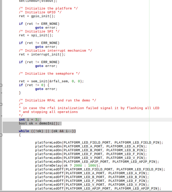

From what I can tell, this is the point at which it fails, inside main.c
0693W00000Nt4NkQAJ.pngThe highlighted portions there, and it explains the blinking behavior I've been seeing.
