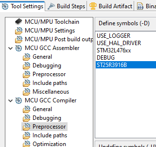

For the ST25R3916B device, projects from the X-NUCLEO-NFC08A1 folder of the ST25 Embedded NFC Library has to be used i.e. the application has to be compiled with ST25R3916B compilation switch. In STM32CubeIDE, open the project properties, C/C++ build/Setting :

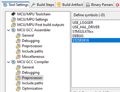

For the ST25R3918 device, it is supported as a ST25R3916 device (non-B version of the ST25R3916). Projects from the X-NUCLEO-NFC06A1 folder of the ST25 Embedded NFC Library has to be used i.e. the application has to be compiled with ST25R3916 compilation switch. When compiled with the proper define (i.e. ST25R3916), the identity register of the ST25R3918 is properly managed and it not needed to make changes in the st25r3916CheckChipID().
The analog settings for ST25R3916/18 (non-B versions) and for ST25R3916B are different. Using the wrong analog settings will cause RF communication issues.
When using ST25R3916 (non B version) or ST25R3918, make sure to add analogConfigTbl_NFC06A1.c in your build and to define RFAL_ANALOG_CONFIG_CUSTOM in the rfal_platform.h for this project.
When using ST25R3916B, make sure to add analogConfigTbl_NFC08A1.c in your build and to define RFAL_ANALOG_CONFIG_CUSTOM in the rfal_platform.h for this project.
