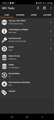

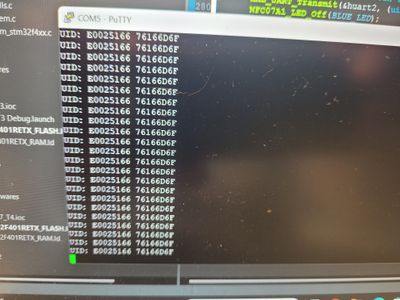

I have already familiarized myself with data input and output via USART. However, I first tried to read the UID of a tag. A UID is always displayed without using a tag. It turned out that it is the UID of the NFC07A1 because I read the UID of the reader using an Android app (just mirrored). As soon as I use my phone as a tag and hold it to the reader, an error message appears. Any other tag I have tried is not even recognized. Only the phone, but it is not readable.

I think there is a misconception here: NFC07 is an NFC tag and not an NFC reader. It will not be able to read other tags.
It is a so-called dynamic tag as it has also a wired interface to be able to exchange data with an NFC reader.
BR, Ulysses

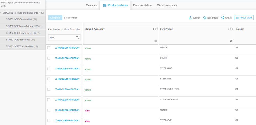

thank you very much for your Reply. I had the NFC01a1 before, but had difficulties to get the library included. So i asked my prof for advise and he gave me this other device.
Looks like i got the wrong device.
