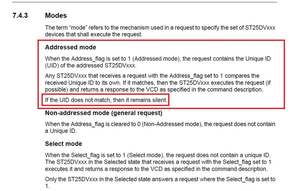

As documentation said, the tag didn't response if the message didn't contains the correct tag UID:
Maybe UID byte order (LSB/MSB) in Write Message is inverted and tag expects the other order?
Could it be a reader (smartphone) incompatibility in ISO-15963 for address mode transactions (I use the same reader device all the time)?
