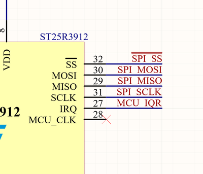

I have developed a product of a USB type-C charger for a smart card. For the NFC reader, I have used ST25R3912 as a slave with an external clock of 27.12 MHz and for the host, I have selected STM32F030K6T6.
1. Is it possible to use an external clock of 32.768 kHz for the host?
2. Can you recommend the external clock for the host?
Best
Dalik
2023-10-10 8:49 AM
I would recommend to use STM32CubeMX that will help you to define your clock tree for your MCU.
The STM32F030K6T6 is having a LQFP32 package where the OSC32-IN and OSC32-OUT pins are not present (thus it is not possible to use a Low Speed External 32.768 kHz crystal).
Depending on your application needs, you can clock your system either from the High Speed Internal (HSI) 8 MHz RC clock or from an High Speed External (HSE) 4-32 crystal (providing a better clock accuracy but of course with an impact on your BOM). See RM0360 Reference Manual §7 for the description of the various clock.

ST25R3912 has an MCU_CLK pin, but my product uses charger power only and I need to know about the Power level from the card.
1. Does This pin need to be used?
Best,
Dalik
2023-10-17 1:24 AM
The MCU_CLK pin may be use as clock source for the external MCU. The main use case is when using the transparent mode which is likely not your case (see https://community.st.com/t5/st25-nfc-rfid-tags-and-readers/mcu-clk-as-microcontroller-clock-source/td-p/232591 and other related posts. Se also the § Pin MCU_CLK in chapter 1.2.11 in ST25R3912 datasheet).
So I believe this pin is not needed in your application.
Rgds
BT
