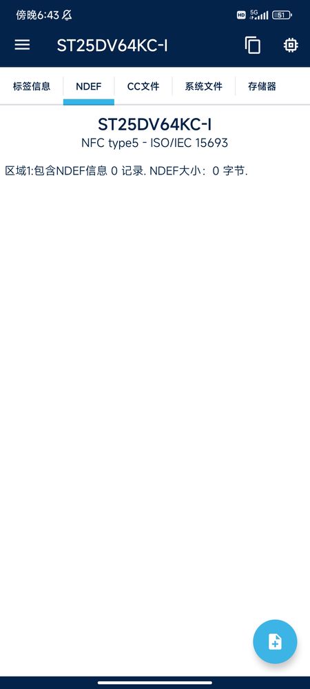

2023-03-16 7:11 PM
Hello, I wrote an NDEF message with your reference code, but the phone did not read any messages.

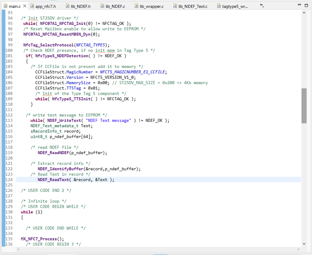

2023-03-22 6:04 AM
@Rene Lenerve
I wish you can help me check if the code can implement this feature, is there a bug?
I still can't read NDEF messages using app
2023-03-22 7:18 AM
Hi @帅 罗,
I think your issue come from this line (106):
CCFileStruct.MemorySize = 0x00;with that you are saying that the tag's memory size is 0, which result in the St25 App to display no data in NDEF field. A value of 0x40 represent 4Kbits (512 Bytes). It can be another value of course.
Another point to update may be the type for the Text variable, for me it's compiling with NDEF_Text_info_t as type.
Let me know if that helps you.
Kind Regards.

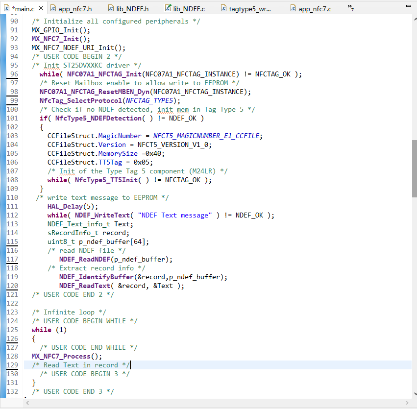

2023-03-23 12:51 AM
Hi
I have modified the code according to what you said. Could you please help me to see if it is possible to read NDEF information
2023-03-23 1:03 AM
Hi @帅罗.1 (Community Member),
You need to erase the memory of the Tag to rewrite the CC file, because with this code the NDEF detection doesn't enter the NfcTyp5_TT5Init process and CCFile keeps the old values.
You can perform this by erasing the tag memory with the NFC Tap App or in debug mode on the nucleo board by jumping the line "if ( NfcTyp5_NDEFDetection() != NDEF_OK )"
Kind Regards.
