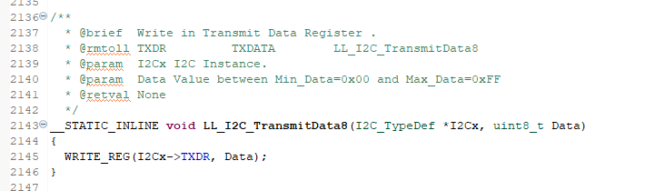

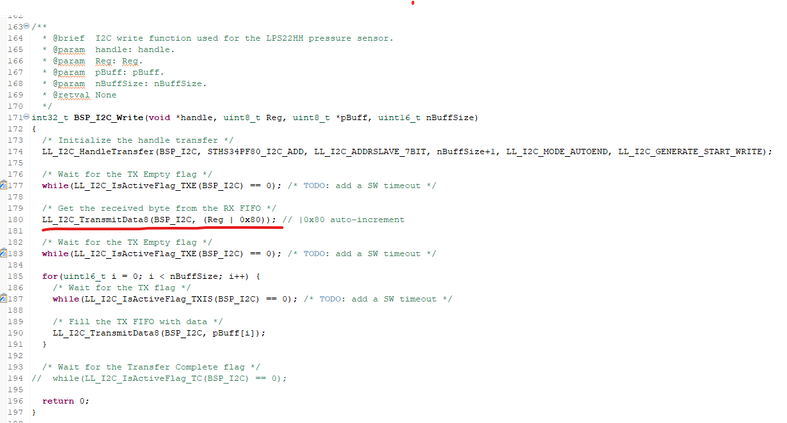

I´m trying to use LL driver for the communication with ST25DV64KC chip, the register address of this chip is 16bits, but the current LL driver only supports 8bit, I tried to adjust it and failed.

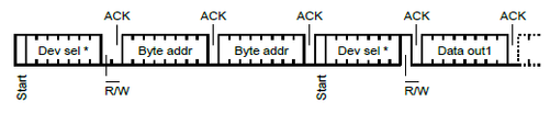

The ST25DV tag can be seen as a standard EEPROM on I²C side, so the process to write to a register or memory area is the same (difference between register and memory is done with the value of device select). It follows this frame:
After the device select, you just need to send data in bytes, with the first 2 the memory address (or register address), each byte is sent one after the other. So you can use the LL_I2C_TransmitData8 for that.
For the read function, you will need to first send device select for Write followed with the 2 bytes of address, then restart with device select for Read and get data from the tag (read receive register).
