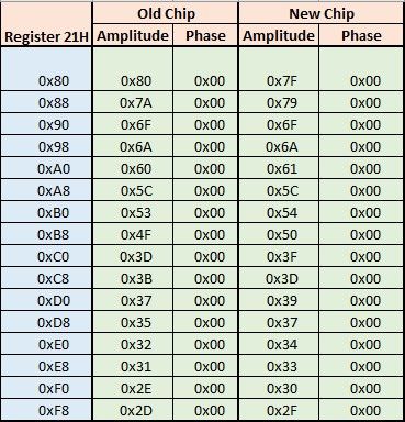

2021-05-10 11:25 PM
2021-05-10 11:42 PM
Hi Sarav,
can you double check your phase measurements it is always 0x00 (>=150deg)? Which function did you use? From RFAL?
With such a phase for all trim values the Calibrate Antenna should always have produced an error (also in the old ST25R3911) as the target phase could not be achieved.
I will need to discuss internally, it would be helpful if you could use VNA to produce smith charts of at least trim values 0, 7 and 15 and share them here or with me.
Regards, Ulysses
