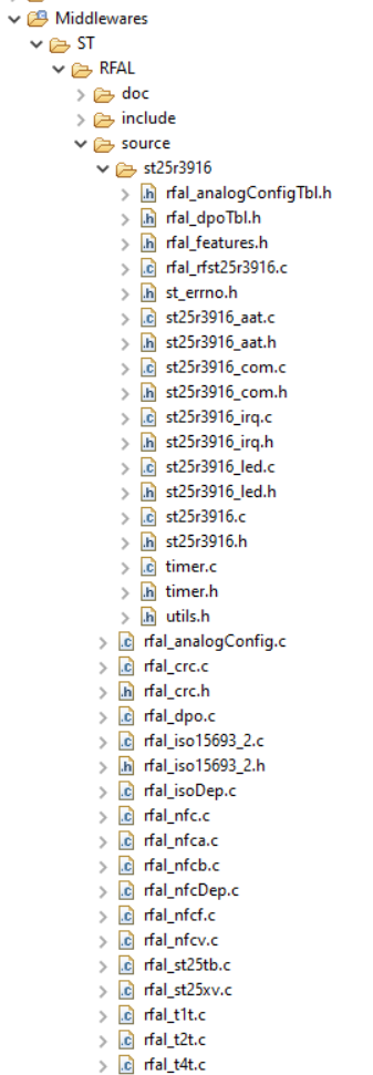

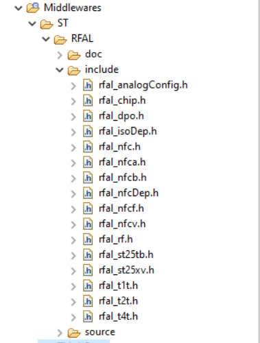

I'm having trouble integrating RFAL for ST25R3916 with an STM32F2xx project. I downloaded RFAL from here: https://www.st.com/en/embedded-software/stsw-st25rfal002.html#overview. I am trying to follow the steps from section 4.3 How to Run the First Example of the user manual: UM2890 - User manual RF/NFC abstraction layer (RFAL).
The library did not include the following files: st_errno.h, timer.c, timer.h, utils.h. I copied these files from the xcube NFC library as a work around: https://www.st.com/en/embedded-software/x-cube-nfc6.html
I added the RFAL files under the Middlewares directory of my project (see below images), and added these files to the include paths0693W00000HqoeNQAR.png0693W00000HqoeXQAR.png
I created a platform.h file from the appendix of UM2890 - User manual RF/NFC abstraction layer (RFAL).
