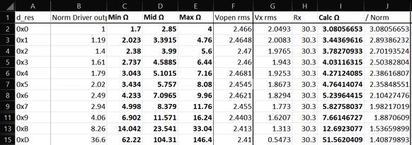

I was able to find the resistance values and also measure them using a resistor as the load to calculate the driver output impedance (sum of both RFO1/2). It approximately correlated to Table 126 and Table 78. Results and calculation used attached below. I used an oscilloscope to measure the load voltage.

What I am unable to measure with this method, and need to know, is the imaginary part of these measurements. In other words, what the capacitive and inductive loads are as well for at least the RFO1 and RFO2 drive output value (i.e. Table 126).
