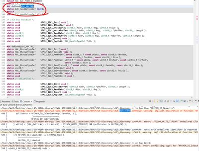

2025-11-25 11:35 PM
Hi BT
Thanks for your reply, in terms of FW, there are some errror occured after added the changes you suggested.
In your FW, hi2c2 only can be used in st25_discovery.c, and USE_NFCTAG needs to be defined for enabling hi2c2 related code.
could you help to check? or the FW I am using is not the latest one?
Thanks
Leo

2025-11-28 12:41 AM
Hi Brian,
I also need to define "USE_NFCTAG" for enabling STM32_I2C2_Init and I2C2 related functions, but some errors occured after I defined USE_NFCTAG in define symbols.
Could you help to run at your PC? I don't know if I am lacking some source files or not.
Thanks,
Leo

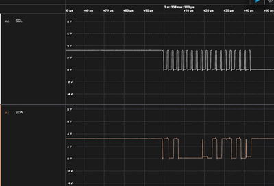

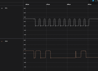

2025-11-30 9:25 PM
Hi Rene
Thanks for help, now FW can be compiled and programmed to the board sucessfully.
but now the program is stuck at "InitializeRFAL"function.
I checked I2C waveform, it looks like SCL pin will latch sometime, as below, do you have any idea?
Thanks,
Leo

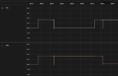

2025-12-01 6:26 PM
Hi Rene
I have tried all of V_RF configuration, the result still remain the same, SCL latched during InitializeRFAL.
I will contuine to check where is the issue, but I also need your help to fix this issue as well.
Thanls,
Leo
