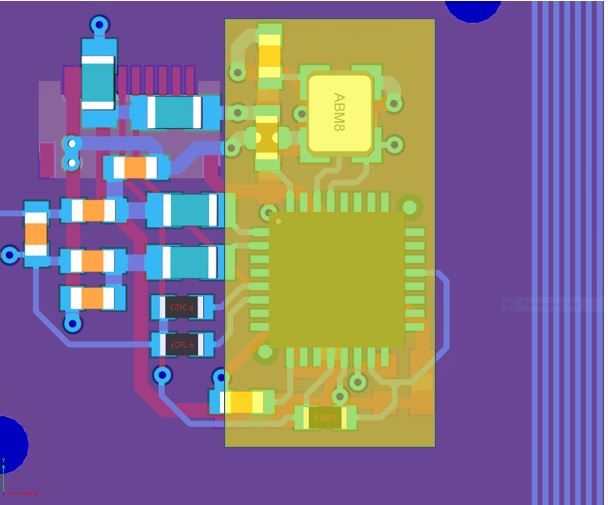

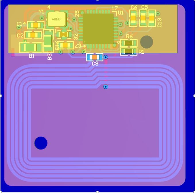

2021-01-21 3:42 AM
Hi Gokula,
thanks for sharing your new designs.
Keeping copper ground plane as shield around components is generally recommended, particularly arounbf cristal oscillator and tuning circuit. Don't know you design rules like clearance around tracks, but it is possible without living too much dead copper, you may try to restore a bit grounf plan on design with components out of the antenna. you may start ground plan on a line B1-R1 (to leave 2mm minimum between groung plan and antenna, up to the PCB border close to the crystal.
For designs with components inside the antenna, you may just put some ground plan to shield the crystal oscillator and CR95HF.
see pictures below, ground plan suggestion in yellow.
best regards,
Henry Crane
