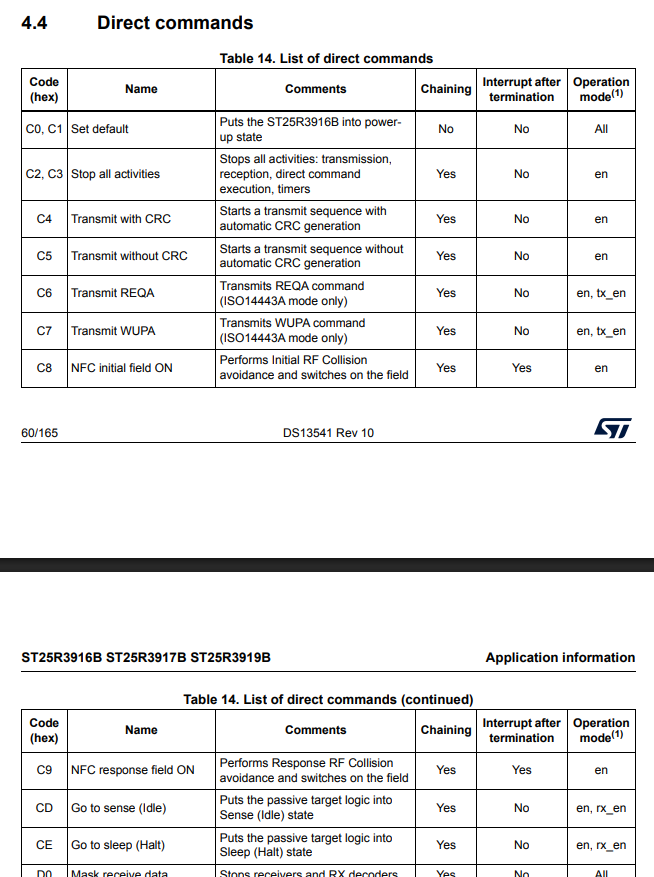

@LeoWu wrote:it looks like it's hard to understand the protocol through I2C waveform, and no any protocol document is avaiable on your website.
There's a list of commands in the datasheet:
https://www.st.com/resource/en/datasheet/st25r3916b.pdf#page=60
via: https://www.st.com/en/nfc/st25r3916b.html#documentation
2026-01-06 6:25 AM
Hi Andrew,
The RFAL library provides an abstraction layer that eliminates the need to manage register-level commands described in the datasheet. Therefore, the use of the RFAL library is recommended: the same API can be reused on different products of the ST25R family without having to change the application code.
Rgds
BT
2026-01-06 6:34 AM
Indeed.
But if @LeoWu wants to write something from scratch, the datasheet would always be the place to start...
