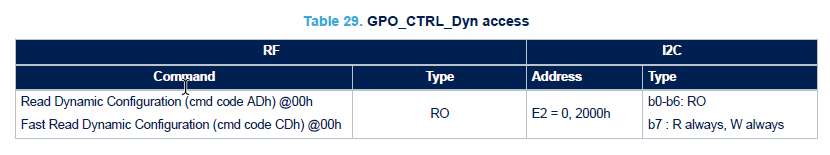

did you check the DS? I find:
which IMO backs your observations.
Regards, Ulysses
2023-01-11 7:10 AM
Which DS is this??? It looks very different than the one I have!
2023-01-11 7:33 AM
2023-01-11 9:07 AM
Interesting - the hyperlink for that field goes to the table in the next page - so I never noticed that section on the previous pagethat marked b0-b6 as RO!
