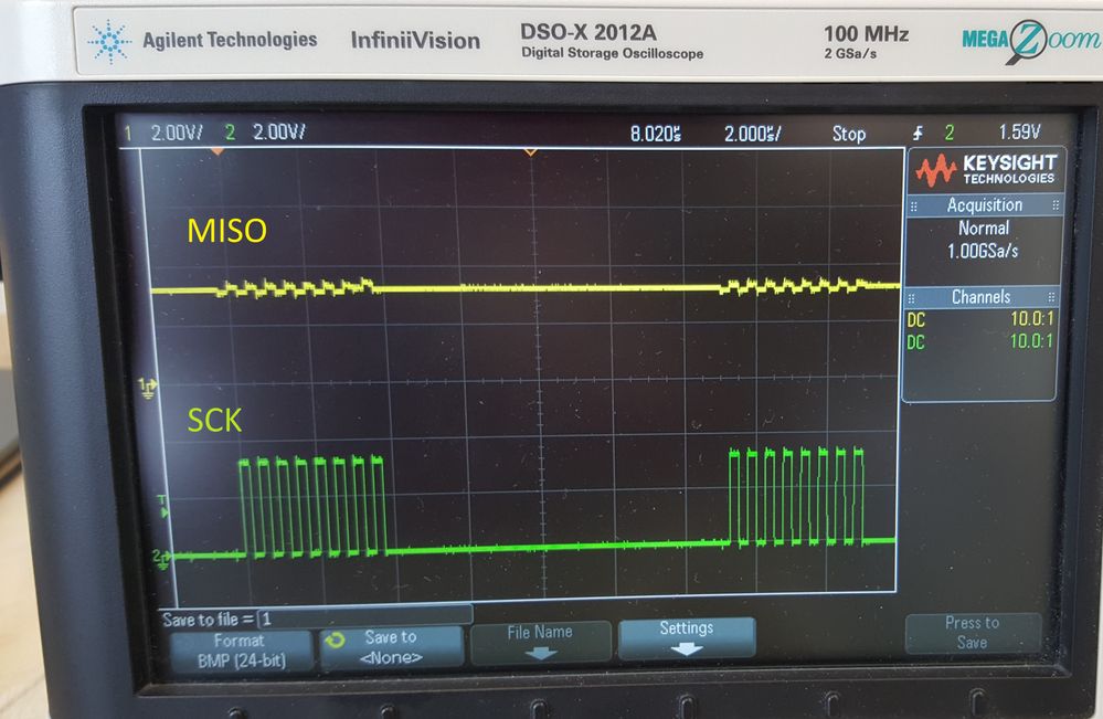

I am using the X-NUCLEO-NFC03A1 board with an Atmega328p MCU and atmel studio.
I have been trying to communicate with the CR95HF via SPI but I cant seem to get any reply on the MISO line. The MISO line never drops below a certain voltage level (around 100mV).
Any idea what might be causing this? I checked that the SCK, MOSI and CS signals all have good integrity on the CR95HF chip. I have attached a picture of the SCK and MISO signals.
Thanks in advance for your help
2021-02-19 7:22 AM
on your scope screenshot, I see only nIRQ_IN rising once from 0 to 3V3. Can you confirm that you follow the startup sequence as described in ST25R95 datasheet §3.2
Can you provide a screenshot of the full startup sequence from power on to t3?
If this startup sequence is properly followed and the X-NUCLEO-NFC03A1 still not replying, can you plug this board on a NUCLEO-L476RG, NUCLEO-F401RE or NUCLEOF103RB board and run the firmware from X-CUBE-NFC3 (binary are provided). This will help to verify that the X-NUCLEO-NFC03A1 has not been damaged.

2021-02-19 4:25 AM
can you probe the IRQ_IN during the startup sequence (see ST25R95 datasheet §3.2) and share the startup sequence with me.
I would also suggest to check that after the completion of the startup sequence:
How is the MISO connected to the X-NUCLEO-NFC03A1: is there any pull up resistor on MCU PCB side? Can you disconnect the MISO on MCU side and probe the MISO on X-NUCLEO-NFC03A1 side (i.e. with MISO being left floating)?

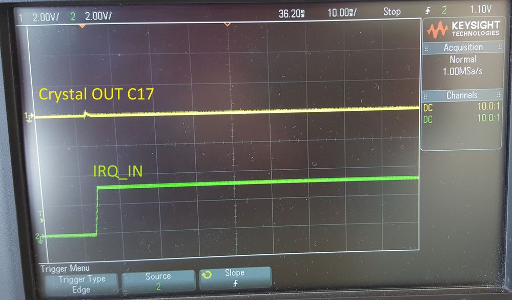

2021-02-19 5:32 AM
Hi Brian,
Please see the attached image, it seems that there is no output form the crystal. I measured the signal on XIN and XOUT pins individually with no resultant clock.
I disconnected the MISO from the MCU and the result was the same as seen in the previous image.
Any suggestions?
Regards,
Salman
2021-02-19 5:35 AM
IRQ_OUT is also high

2021-02-22 3:36 AM
HI Brian,
I followed the startup sequence you indicated and its working now, thanks.
