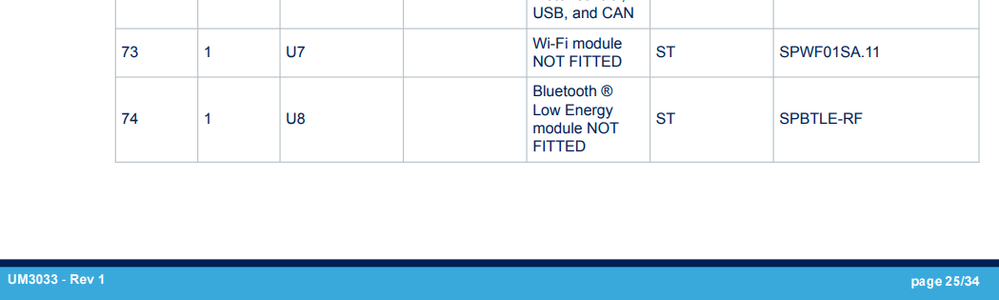

It (and the WiFi module) is listed in the BoM:
Although @Alan BST says they're discontinued, it seems you might still be able find some in stock; eg,
Of course, there's nothing to stop you adding BLE using any other module of your choice ...
