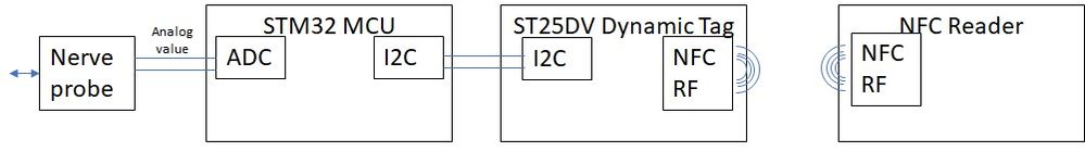

Hi
my understanding of your use case is the following:
  • probe an electric nerve signal
  • convert its analog value to a digital value
  • exchange this digital value through NFC to a equipment that would record the different values.
If my understanding is correct, the following proposal could be used
You can use for example the ST25DV-DISCOVERY kit to prototype your application. Some test points seems to be available to connect to an ADC analog input channel (for example TP4).
Rgds
BT

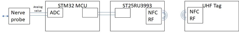

Brian TIDAL
​Hi,
ST25DV-DISCOVERY is is based on NFC ST25DV04K Dynamic tag. Anyway, this can be used for protoyping applications for ST25DV-I2C series Dynamic NFC Tags.

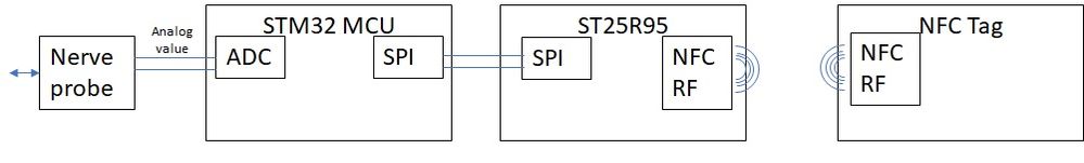

ST25RU3993 is an UHF reader used to read/write UHF tags. Do you plan to store you records inside a tag? Something like:
(or like this in case of NFC)
Feel free to clarify your use case:
  • data storage; in a tag or in a device attached to the reader?
  • reading distance (impact on choice between UHF and NFC)
  • data volume,
  • etc.
Rgds
BT
