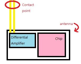

SHONG.11
Associate II
0693W000001cIZ9QAM.jpgit is just an pure conductor and will be attached on the neuron
it is just an electrical signal
so will just contact at the nerve with conductor
Hello Shong.1
when looking at your block diagram: the block denoted as "Chip" - is this meant to be the ST25RU3993 or a tag chip?
Cheers,
B
It is gonna be ST25RU3993
the information what i want to obtain is electric signals which will come from the yellow conductor lines
is it possible?
or if you have any other recommendation for RFID Chip
it might be really thankful
I really anticipate your answer

Hello Shong.1
ST25RU3993 can talk to passive or to battery assisted passive RFID tags only.
