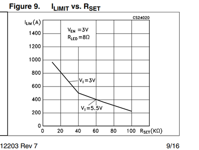

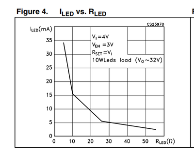

2024-07-08 11:34 PM
Hi Peter,
Thanks for your feedback.
Could you help share the equation of ILIMIT and RSET, ILed and RLED?
I cannot find the equation in datasheet.
