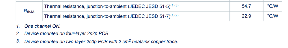

How good is your cooling? center pad soldered ? ...to what ? how big is copper area ?
see ds:
