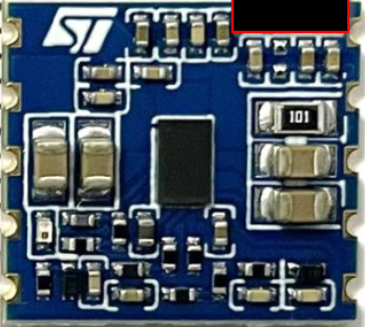

We plan to release MPP stamp module, do you consider it?
2024-08-20 3:32 AM
Interesting. If we would have to start over the project (so the layout was not done already) we would definitely consider it, also depends on pricing.
