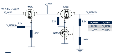

I'm looking for a reference schematic where I can use the STWLC38 for Qi charging, but the Qi charging will be disabled when a USB-C is plugged in. I also need the USB-C Vbus to be isolated from the connector while the Qi charging is active.
I'd really like to have the configuration be controlled automatically by the STWLC38, if possible... Much like this from a competitive device. Is that possible?

Hi @BPolinske
Here is example of Wire and wireless switch circuit, it use some NMOS and PMOS.
When VBUS high, Vsys connect VBUS
When VBUS low, Vsys connect V_WLC RX VOUT

2024-01-31 5:57 PM
Also i want to highligh this switch circuit advantage.
RX do not need power by external and RX do not consume any power from battery.

I assume with a PMOS we can also tie V_USB_5V to the gate and the enable pin to the drain to disable the STWLC38 when USB is applied..??
