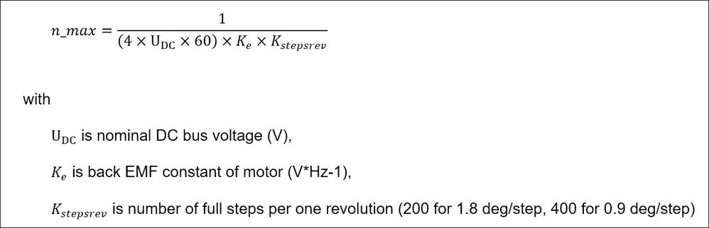

4. For maximum speed which you can achieve by bipolar stepper motor is in voltage mode

2023-12-13 2:39 AM
I found this interesting formula above in this thread, but I can#t figure out, what is the unit of n_max. If I use this formula for a typical stepper motor, I get a result of 0,000005787. Udc=24V, Ke=0,15V/Hz, Kstep=200.
What is the unit of n_max?
Thanks in advance,
