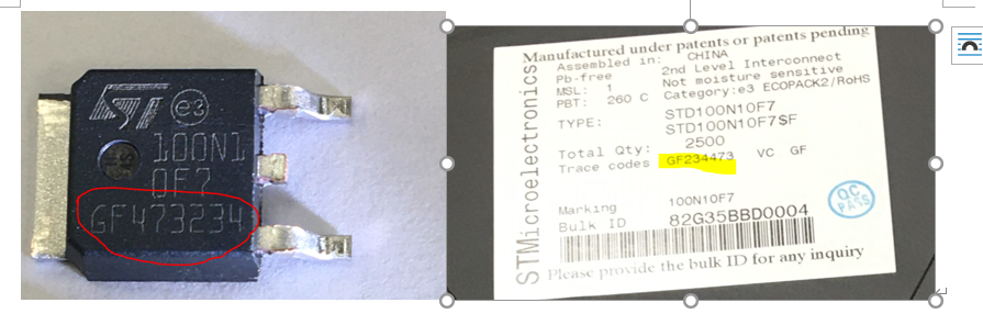

our IQC team would like to know that why the trace code is different between label and component Text , please see the attached
and also could you please let me know the date code of this batch .

The trace code GF473234 on your STD100N10F7 is correct, i.e. date code 234 = 2022, week 34. However, someone accidentally mixed up the two groups of 3 digits on the label, i.e. 473 and 234. You can therefore assume that everything is in order and only the label was printed incorrectly.

2022-11-02 5:56 PM
Hi, @Peter BENSCH :
Yes, it's clear to me now, Thank you so much .:grinning_face:
