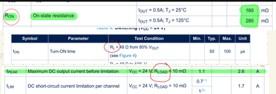

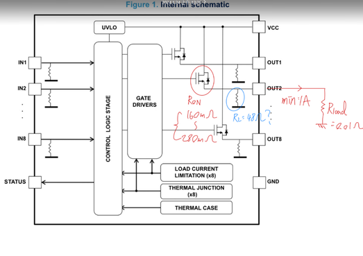

Hello, I noticed that some test conditions in the data sheet use RL and Rload (figure.1)  for  testing. To avoid any misunderstandings about resistances, I annotated the internal schematic using the information provided by the company. Could you please help me confirm if it  (figure.2)  is accurate as indicated in the image? Then, is the situation you mentioned earlier, "Iout min is 1A," applicable regardless of the load resistance in any condition?
Thank you for long time reply
Peter BENSCH
RL and RLOAD are identical and are only alternative designations. They have nothing to do with the resistors connected internally to GND at the outputs visible in figure 1. Those resistors at GND are probably a copy'n'paste error, because they were also not included in older data sheet versions and are used for open load detection in other high-side switches, which is not realised in the VN808CM-32-E. You can therefore ignore these GND resistors at the outputs.
The switch-on resistance of the high-side MOSFETs is indeed max. 160 mohms measured at 0.5A and ambient temperature 25°C, or max. 280 mohms at 0.5A and ambient temperature 125°C, as shown in table 3.
The switch-on time tON specified in table 4 was determined with an external (regular) load resistance of 48 ohms, while the protective function specified in table 6 was actually tested with an external (short-circuit simulating) load of 10 mohms.
Finally: "Iout min is 1A," is confirmed by the protection function, the values of which are listed in table 6. The value of IPEAK mentioned there describes that the high-side switch is switched off at the earliest at min 1.1A and at the latest at 2.6A.
Summary: with the exception of the resistors at the outputs mentioned first and visible in fig 1, which are not present, all data correspond to the facts. On behalf of the company, I would like to apologise for the incorrect drawing in fig 1.
Hope it is clearer now?
Regards
/Peter
