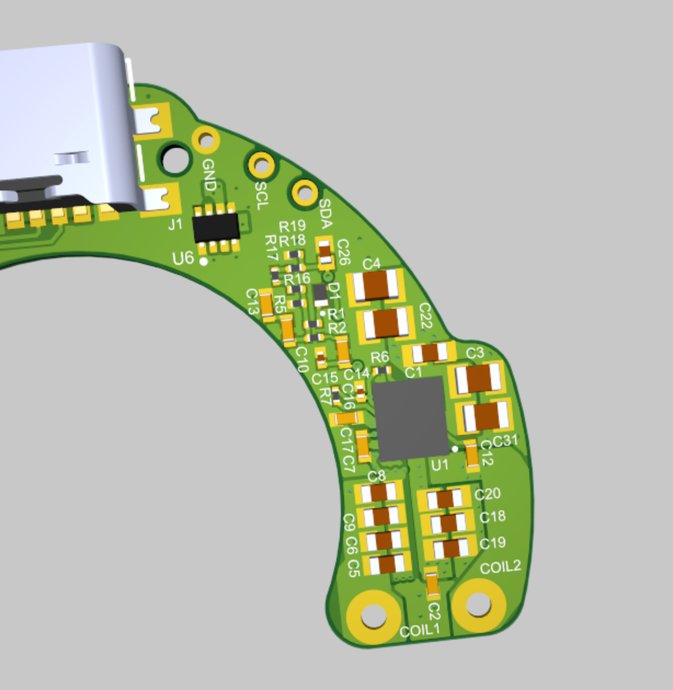

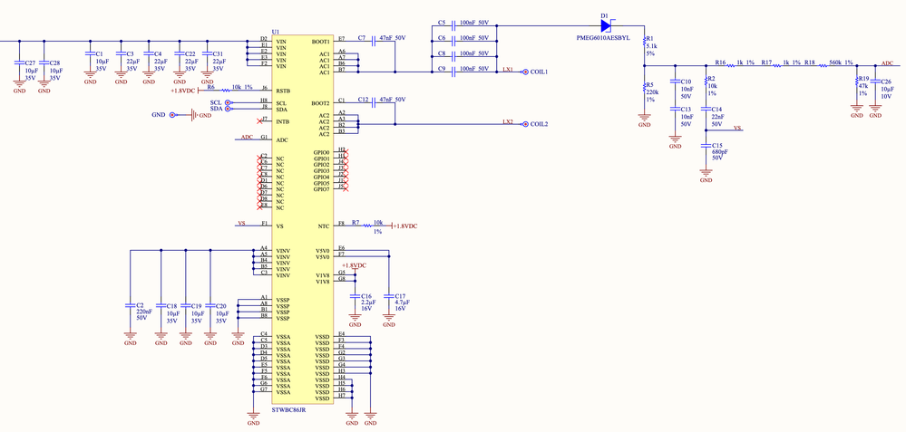

Transmitter design

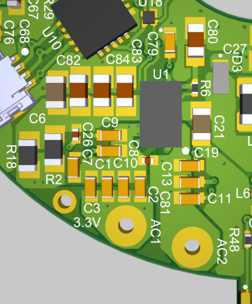

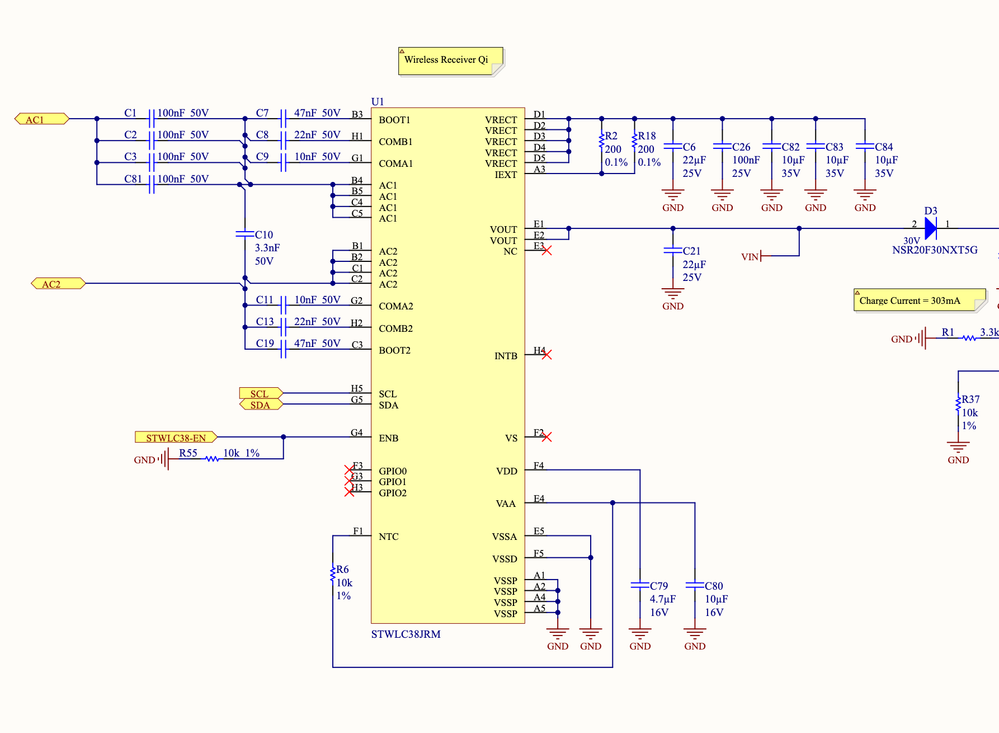

Receiver Design

willzhou
Hi Kevin
Since your distance is longer 2.5mm -- 6mm, TX work at 12V, RX work at 5V,you need change your coil spec, due to our EVK is for TX 5V and RX 5V with 2mm distance.
1 REPLY 1
willzhou
Hi Kevin
