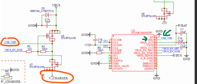

Hello everyone, I used STUSB1600 as the type-c dual role type power management. When it works as sink type, it is good. But when it works as source type, it doesn't work. I found VBUS_EN_SRC always keep high. This is my design schematic, could you please provide some suggestions. Thank you so much!

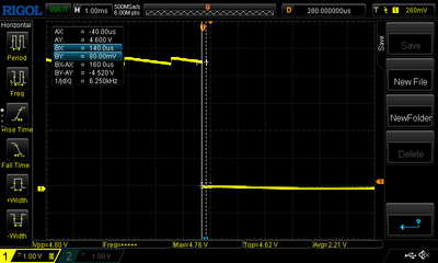

As stusb1600 is in DRP configuration, without any cable connected, I do expect to see CC toggling between ~3V and 0v
By default, Rp is setup to advise 3A so when Sink is connected, I expect to see 1 CC pin at ~1.6V.
If CC are zero when connected to sink, it means that stusb1600 is in ErrorRecovery state (it has disabled its resistors): most probably, the device detects wrong voltage on power paths.

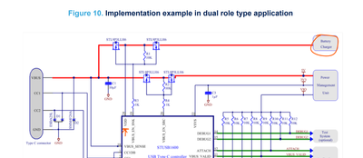

VDD pin should be connected between U8 and U9 from your schematic: see fig 10 of our datasheet.

Thanks for the clarification. I just found out why the STUSB1600 cannot be used as a source. On the PCB I was testing, I connected VSYS to GND. When I reworked the PCB and tried to connect VSYS to 5V, as shown in the figure above, vbus_en_src is normally pulled low, and the STUSB1600 could be used as a source to output to external devices.

Thanks again for your advice. But I think the VDD in the datasheet is connected to the branch that controls the Battery Charger, which is the same as my schematic.

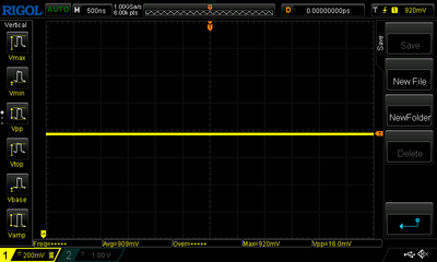

And this is the CC1 waveform:

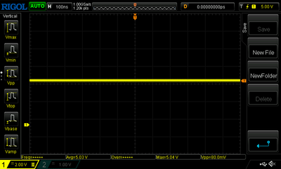

This is CC2 waveform:
