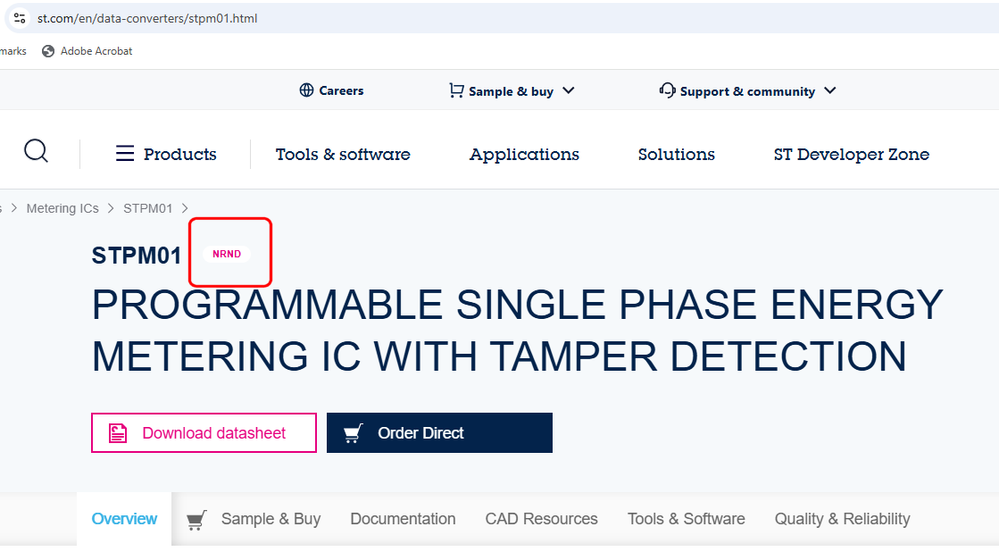

Note that STPM01 is Not Recommended for New Designs (NRND):
