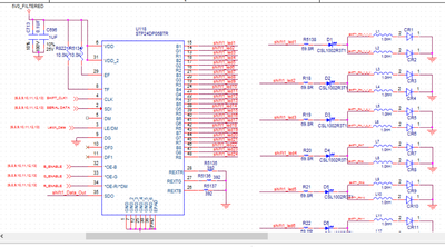

Hi Peter,
Thanks for the reply. Could you please check the below schematic. Here STP is used for biasing several pin diodes.
2024-08-30 5:07 AM
No, the LEDs D1...D8 are connected completely incorrectly and also do not require any series resistors: STP24DP05 does not have high-side drivers without current limitation at its outputs, but current-controlled low-side drivers. So you only have to connect the LEDs with the anodes to the LED voltage and the cathodes without resistors to the RGB outputs of the STP24DP05.

2024-08-30 5:28 AM
Hi Peter,
CR1-CR11 are pin diodes.
As per our application, We need to drive the LEDs for on and off condition at 1.4V and 50mA current. STP24DP05 output pins voltage is 5V so to drop this to 1.4V we have connected series resistor.
When the microcontroller send bit 1 then LED(D1-D8) and Pin diodes (CR1-CR11) will be on and when when microcontroller send bit 0 then they will be off.
Kindly check.
2024-08-30 7:42 AM
No, your idea is still wrong: the STP24DP05 does not have an output voltage of 5V, but internally drives a current to GND. Please take another close look at the data sheet so that you understand: figure 2 already indicates this because it shows an example of a current source that drives the current to GND, figure 17 also shows the connection of the LEDs.
Pin diodes are not necessary in this application.
2024-09-08 11:35 PM
Hi Peter,
As per our application we require 5V output Voltage and 50mA output current. According to Table 7 of STP24DP05 datasheet VOH(min)=(VDD-0.4)V. In our case VDD=5V so we can expect output voltage 5V on all serial output datas.
And in the same table maximum output current it can drive is 80mA.
Could you please tell this will work as per our requirements or not ?
2024-09-09 12:41 AM
Now I understand your confusion: the LED driver outputs are NOT serial, but parallel outputs, which can then also drive up to 80mA to GND. However, the specification VOL in table 7 refers exclusively to serial OUT, i.e. SDO (pin 35), not to R1...8, G1...8 and B1...8.
Please have another look at the AN3981, where the principle of the LED Driver is shown and discussed: all outputs of the LED array drivers work with the same principle, visible in fig 3, 7, 18 and 28.
Please also read sections 4 (Function of the STP24DP05) and 5 (Common Application Information) in the AN3981. You will then realise that you have to change the following points for a successful application:
