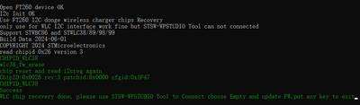

2024-06-12 7:11 AM
Hi
How about you add -o testlog.txt to export some logs
