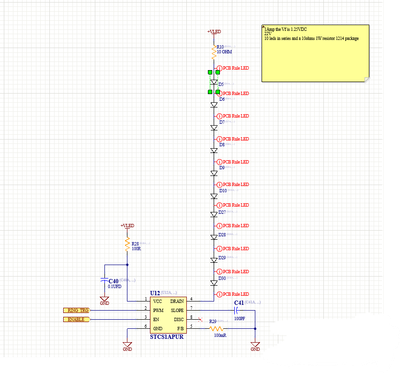

Hi I am using STCS1APUR to drive 10LEDS IR, (MTSM5116MT2-BK), circuit below
current should be 1A as of f/b resistance, enable gets turn on as sson as the STM32 MCU comes up, supplying a 3.3VDC PWM though the MCU
issue:
the voltage drop across the led is only 0.6VDC, and they are dim, when checked the current , its less than 0.04A across the LEDS
when there is no trigger there is a 4VDC deop cmpared to the +VLED(24VDC)
i read the sheep twice and unable to figure out the issue
on time is 250msec
How do you measure that?
LED forward voltages are normally about 1.6V or more ...
@nmohammad wrote:
on time is 250msec
and what is the period?
