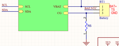

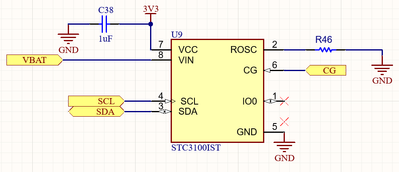

The schematic is as follows:
Thanks for your help.
