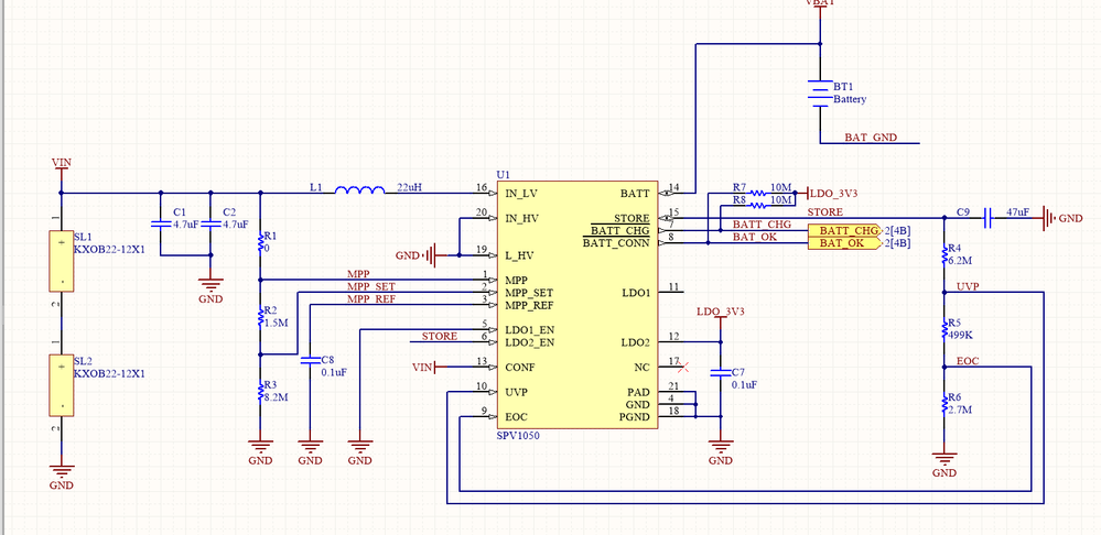

Please see schema below.
With this circuit the cells in series are creating ~ 0.82V in office lighting.
LDO2 output is only 0.5v.  This does not seem right. :)
Can anyone at ST help with correct selection of R1-6 suitable for two KXOB22-12X1 in series charging a 3.7v 100mAh LiPo. One too many equations in the data sheet for me!
http://ixapps.ixys.com/datasheet/20110302-kxob22-12x1-data-sheet.pdf
Voc = 630mV
Vmpp = 501mV
Many thanks.

Desired UVP = 2.75V with EOC 4.2V
R4uvp =  6.8M
R5eoc = 0.75M
R6out = 3M
Bandgap internally = 1.23V
Equation 1
Bandgap = UVP * ( R5+R6 ) / (R4 + R5 + R6)
= 2.75V * 3.75 / 10.55
= 10.31 / 10.55
= 0.90
Equation 2
Bandgap = EOC * R6  / (R4 + R5 + R6 )
= 4.2V * 3 / 10.55
= 10.31 / 10.55
= 1.19
Equation 3
R4+R5+R6 = 10.55M  which is in between 10M and 20M as required by datasheet.
