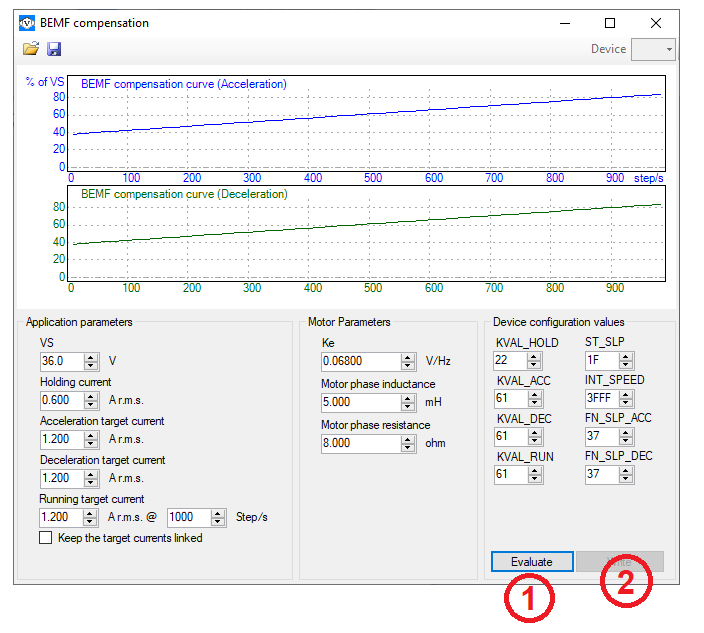

Now you can open the "BEMF compensation" window as shown here:
Set here the correct parameters, so Lm = 5mH, Rm = 8 Ohm, together with the other parameters.
Click the “evaluate button�?: you will still get a warning but you can write the configuration registers for compensation, clicking the “write button.
Now the motor should run properly.
You can even fine tune the slopes (ST_SLP, FN_SLP_ACC /FN_SLP_DEC) in order to keep the phase current as much as constant in the entire speed range of your application.
Try to follow these suggestion and let me know if the motor runs as expected.

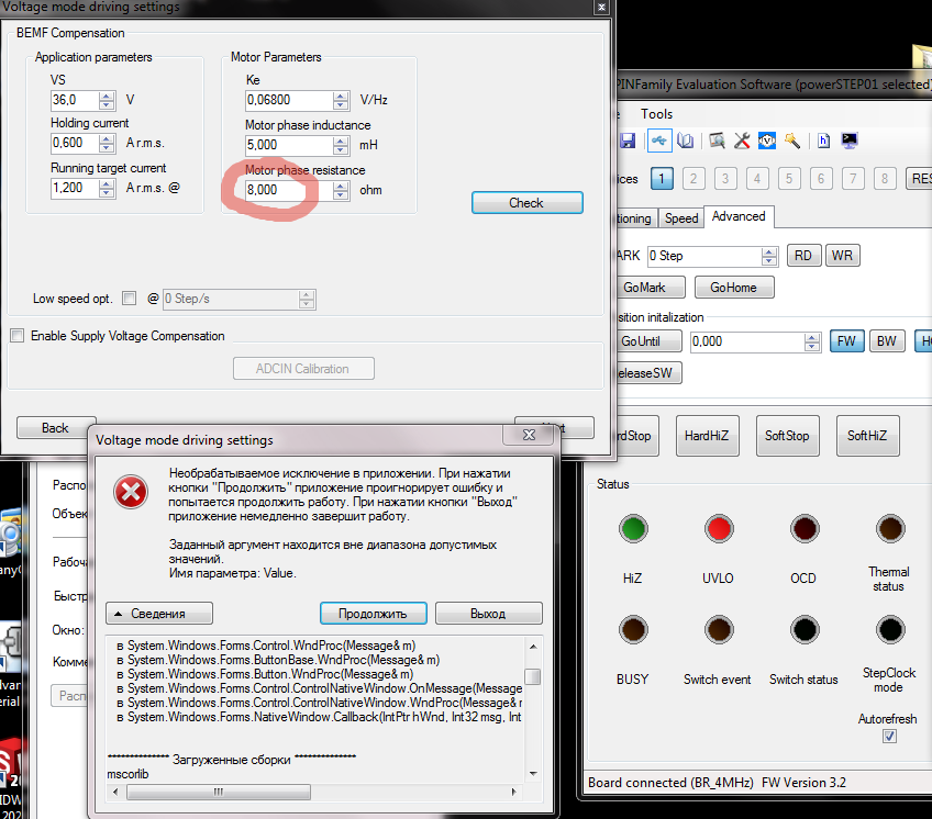

dungeonlords789
Senior III
I use Wizard -> Voltage mode. Look at picture.
Full err text:
Подробна�? информаци�? об и�?пользовании оперативной
(JIT) отладки вме�?то данного диалогового
окна �?одержит�?�? в конце �?того �?ообщени�?.
************** Тек�?т и�?ключени�? **************
System.ArgumentOutOfRangeException: Заданный аргумент находит�?�? вне диапазона допу�?тимых значений.
Им�? параметра: Value
  в xSpinFamily.Parameter.set_Value(Int32 value)
  в GUI.Wizard.VMParametersPage_PowerStep.SaveParameters(Int32 pKVAL_RUN, Int32 pKVAL_HOLD, Int32 pSTSLP, Int32 pINTSPD, Int32 pFNSLP)
  в GUI.Wizard.VMParametersPage.EvaluateRegValues()
  в GUI.Wizard.VMParametersPage.Check_button_Click(Object sender, EventArgs e)
  в System.Windows.Forms.Control.OnClick(EventArgs e)
  в System.Windows.Forms.Button.OnClick(EventArgs e)
  в System.Windows.Forms.Button.OnMouseUp(MouseEventArgs mevent)
  в System.Windows.Forms.Control.WmMouseUp(Message& m, MouseButtons button, Int32 clicks)
  в System.Windows.Forms.Control.WndProc(Message& m)
  в System.Windows.Forms.ButtonBase.WndProc(Message& m)
  в System.Windows.Forms.Button.WndProc(Message& m)
  в System.Windows.Forms.Control.ControlNativeWindow.OnMessage(Message& m)
  в System.Windows.Forms.Control.ControlNativeWindow.WndProc(Message& m)
  в System.Windows.Forms.NativeWindow.Callback(IntPtr hWnd, Int32 msg, IntPtr wparam, IntPtr lparam)

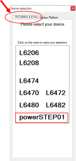

You can try to open the GUI and select the tab “PCC0092 & EVAL�?.

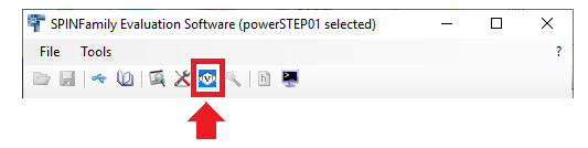

0693W000005ASbKQAW.pngIn this case you can open the main screen , select the “BEMF compensation�? button and open the window without any board connected.
Then, you can set all the parameters and press the evaluate button to get graphs and compensation coefficients.
